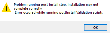

Hello everyone,
so I am trying to install the latest Thingworx Foundation trial. The downloaded trial only contains the twxFoundationH2Trial-8.3.2-windows-installer.exe file.
After having set a password and trying port 80 (and 8080) the installation fails after "Waiting for the Thingworx Platform".
Then the following Error Windows appear:
Attached you can find the installation log.
Any help is appreciated very much.
Best Regards,
Dominik

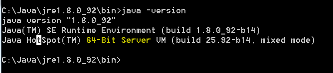

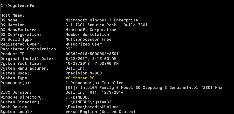

Hi @drieder.
It probably won't work given you've made previous attempts.  However, before trying it on another machine, what o/s are you running?  Is it 64-bit?  Did you confirm you pointed the release to a supported 64-bit java version?
To check the o/s version, you can run the following command from the command prompt:  systeminfo
To validate that you are running a 64-bit java version, navigate to the java installation on your machine and run:  java -version
Refer to the documentation on the support portal for validating the system requirements before running the installer.

raluca_edu
Oct 26, 2018 11:20 AM UTC
Hi Dominik,
Have you set a password with length = 10 , havint at least one uppercase letter, one digit, one special char?
If not, try to set a password  (running again installation executable) for Administrator having 10 chars, one uppercase letter, one digit, one special char.
Thank you,
Raluca Edu
drieder1-VisitorAuthor
Oct 26, 2018 11:55 AM UTC
Hello Raluca,
thank you for your reply. I have tried to run the installation again with the password "Th1ngworx!" and the same error appeared.
Dominik
