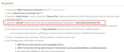

https://www.ptc.com/en/support/article/CS243088

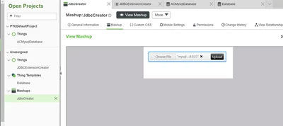

When I try to follow this article to connect MySQL with ThingWork, I got an issue.
According to step 4, I need to upload the JDBC driver file in JdbcCreator mashup. (Does this JDBC driver file refers to MySQL-connector-java-8.0.23.jar???)
But I can not upload MySQL-connector-java-8.0.23.jar.
When I click the “Upload” button, nothing happened. I didn't see a link displayed below the buttons.
In my case, I want to know if I upload the correct file. If I uploaded the wrong file, what file should I upload in this place? Where can I get this file? If it’s correct, why doesn’t it respond after clicking the upload button?

Best answer by mgoel
@ZL_9884170 Hi,
I have few question on which i want to clarify.
1) Have you already downloaded mssql jar/jdbc jar file? If yes which version and from where you have downloaded it.
2) You have mentioned you are trying to upload it in mashup that is not a correct way. We just need to place that jar under tomact/lib folder. After that you can directly create a thing with database template in ThingWorx and set configurations according to your DB instance.
Let me know if you need more clarifications on this.
Mohit
