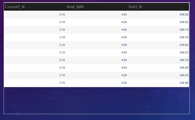

Hi All,
I had read the solution in the community, but still not able to get a transparent background, for the Grid Advanced

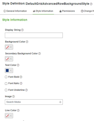

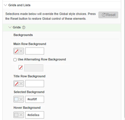

I had tried the following:
1. Created  a Base theme with both the background removed
2. Remove the background for both Row and alternate row..
but i still cannot make the background transparent. can anyone guide me?
I am working on Thingworx V9.10 - Grid Advaced.
Thank you !

Just to make sure, perhaps it is transparent, but your container or panel behind the grid is showing? I would double check all levels up to the actual background you want to show and make sure those are either the right color or transparent as well.
If that is already the case than I'm not sure, maybe you are overwriting it with CSS? else maybe you should try the CSS approach.
