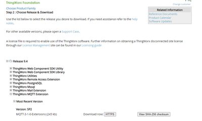

Hi @akartem
You can download the latest version 3.1.0 from PTC website - PTC Software Download - ThingWorx Foundation
/VR
akartem4-ParticipantAuthor
July 13, 2023
That does not work in Thingworx 8.5. It has minimum version set as 9.0, and I also tried to edit manifest and import - that led to all kinds of troubles "Thing is not enabled" and so on
July 17, 2023
Hi @akartem
Please reach out to PTC to get 2.1.2 version
/VR
