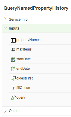

Since which patch does the QueryNamedPropertyHistory as an input option "fillOption" available?
I was looking for this in the documentation and was unable to find it.

It appears this option was added in ThingWorx 9.1.13, 9.2.9 and 9.3.4 and later versions.  There isn't a lot about it in the Help Center, but you can find it on this page.

Hi @jnsousa & @JulienB.
Attached is an update proposed by R&D to our documentation.  Please review it and advise if there are additional changes that would be helpful.
