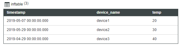

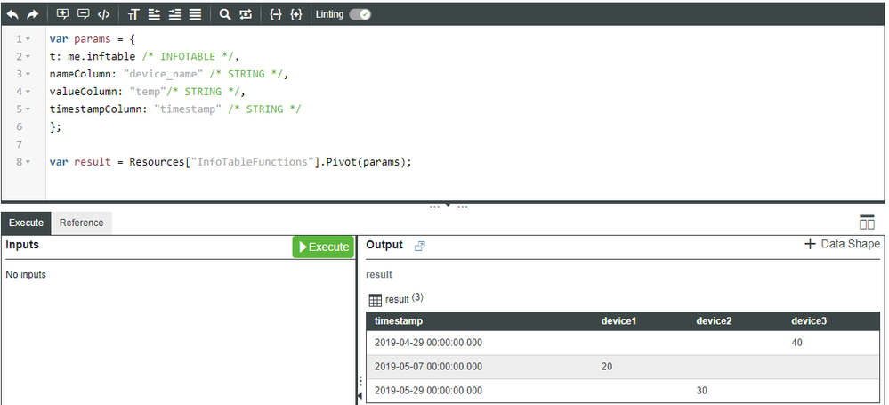

I reproduced your pivot question and for me it works without a problem.
That is the infotable, which I used as a basis:
After executing the service I got the following result:
I guess that meets you expectations.
Can you please check - name column attribute. (You were writing "DEV_NAME", but mentioned in your text above device_name)
A second thing you could check is the output of the service, that this is set to infotable. (As I cannot see that from your description)
