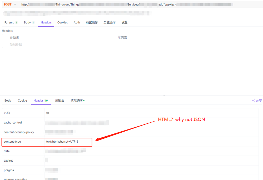

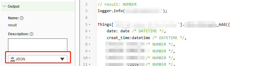

I created a restapi interface that outputs thingworx in json format, why is the response in HTML format?企业微信截图_17117012635491.png企业微信截图_17117013746276.png

Hi @Snoopy_hu
Add header value: "Accept": "application/json"

Hi @Snoopy_hu

Thanks, following your method worked for me, I was also wondering how to set the cookie
