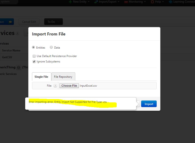

unable to import csv . It gives me error as " Entity import not supported for file type .csv" can anyone help?
  • June 6, 2017
  • 1160 views
I am trying to import a csv file in composer and i get this issue as below
June 6, 2017
Chandrakant it appears you are looking to import the data via that CSV, so you should be selecting Data instead of Entities while importing the data.
