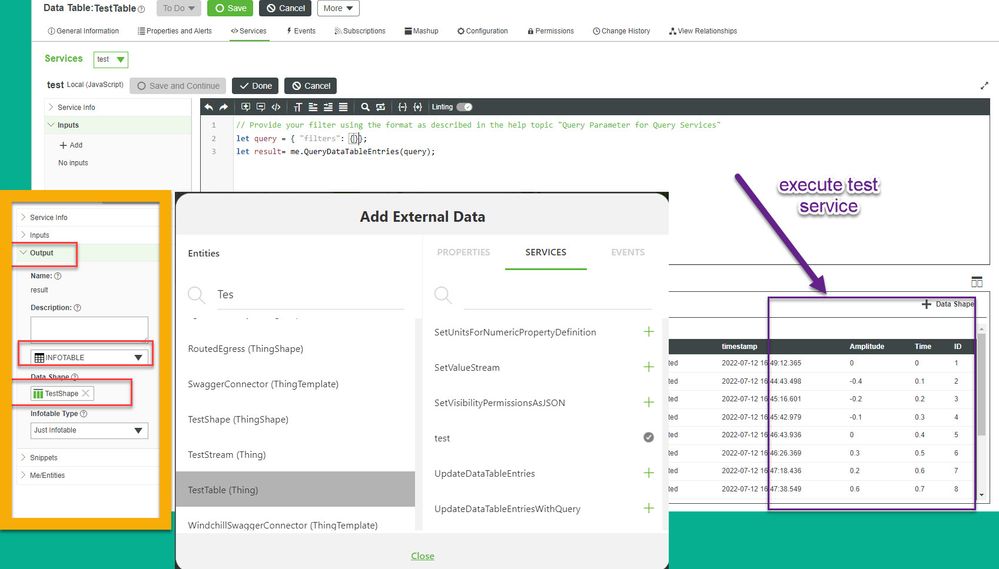

But I used in the past a service which have as  output infotable. In this case I easy could test in Thingworx the out InfoTable and also I could specify the DataShape. I tested with DataTable with a method test which simple returns the whole dataTable as InfoTable.
In your case your service simple could return something like - result= me.YourPropertyInfoTable where the input is InfoTable and the correct datashape is specified (picture above)
Then in Studio simple add the service in the external data and bind the test (serivce)  all items to the data property of the timeSericesChart widget:

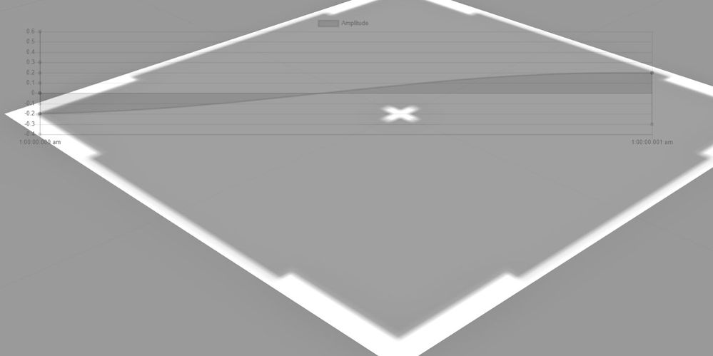

In this case time and amplitude fields were selectable for the axis of the timeSeriesChartWidget.  And tested in preview:

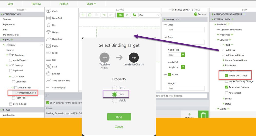

Dear Roland,
We followed the steps you have described(see attached screenshots). Now we are able to select the X and Y axes but still the chart would not show up during preview. Are we still missing something?

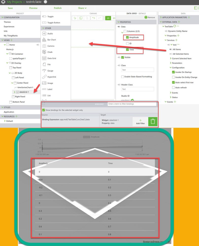

my first impression is that this is correct. So the question - possibly there is some small difference  between the Shape and the format definition of the InfoTable (property type)
To see if the data is coming correctly in Studio - you can check the dataGrid widget to see if this will display the data.2022-07-13_12-08-01.jpg
Because the data is static - in the configuration we do not need auto refresh option
If this will not display the data -you can also check the permission - possibly you can add the method in the permission TWX section and to set in  runtime also execute permissions for the TWX service
