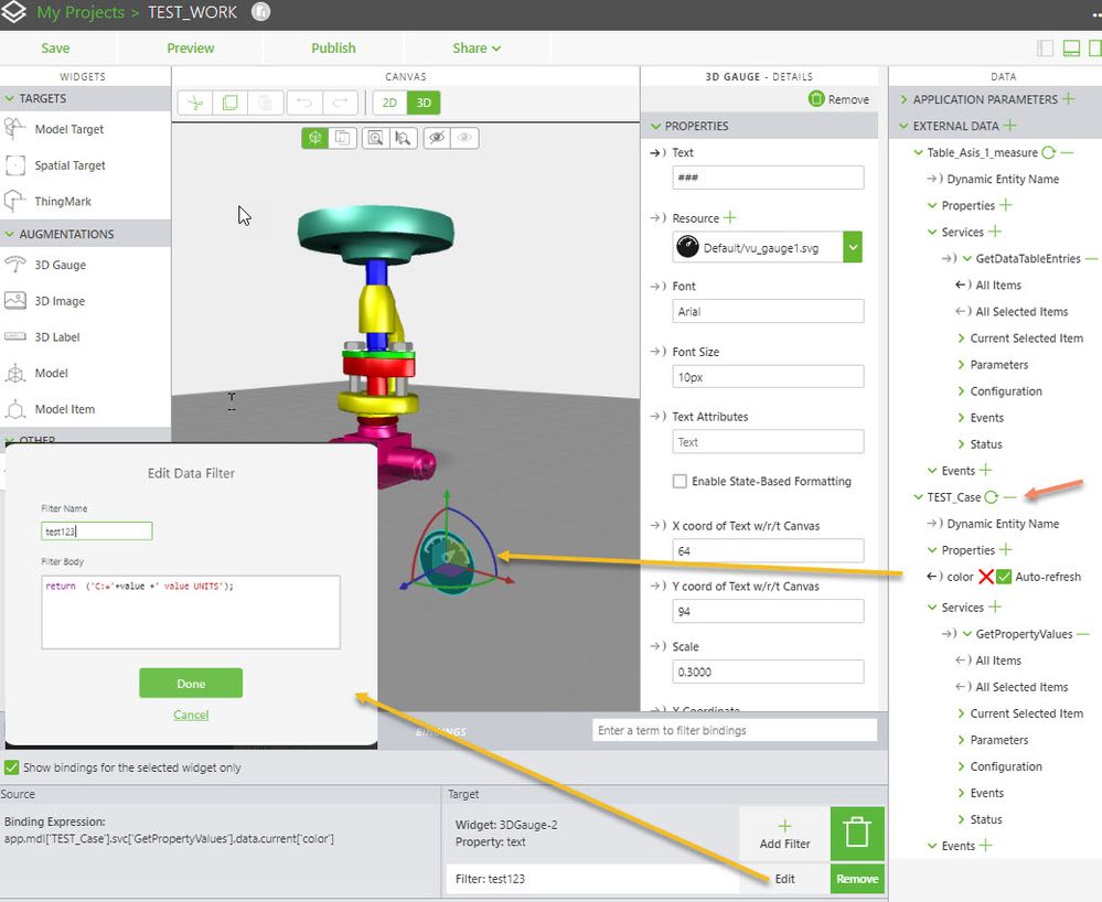

actually it should be possible to connect  Vuforia Studio Experience to you trial composer so you can show a thing properties in your experience.
So it is important that you will use the same URL with the same account (user, pwd)

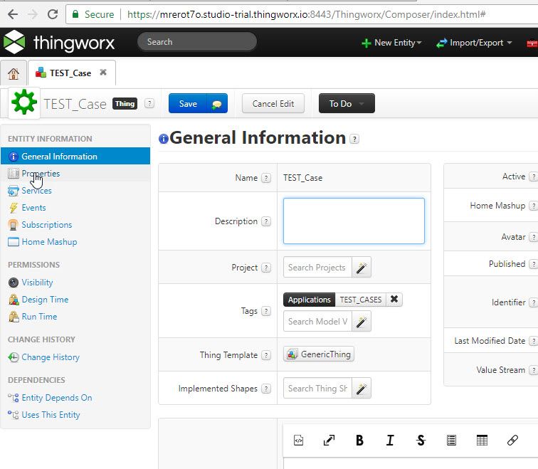

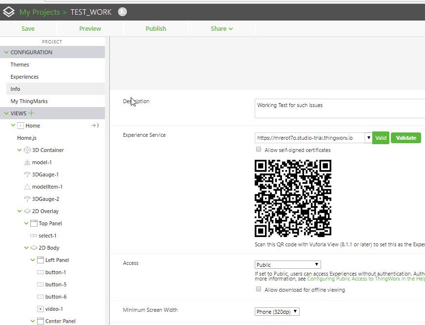

so for example I tested myself on a trial instance . Let asume  that your  URL in your project is: https://rsxfgstt6xo..thingworx.io
in this case  the Composer URL should be :
https://rsxfgstt6xo.thingworx.io:8443/Thingworx/Composer/index.html#
Where you can create a thing with some property e.g. color
Now you can go back to Vuforia Studio and add the it as external data:
So the thing property could be bind to a widget property - example here to the text property of a 3d gauge:
Additionlly the value could be formated by a filter - here addting some unit text.

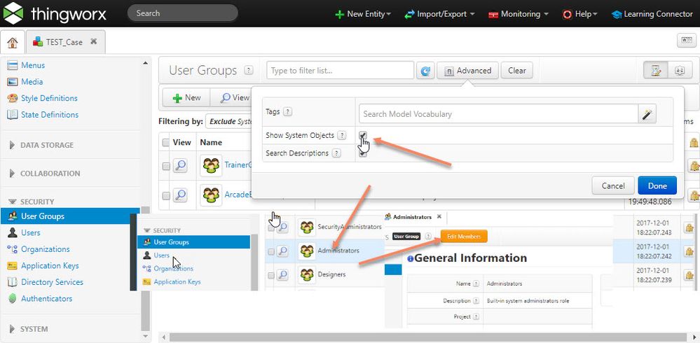

Important point is to check in the composer if your user is a member of the Adminstrator group:

I think according your comment  - you are not member in the adminstrator group. Are you the alone user for this URL /instance  or there are more then one users registred for this instance?
Some time   when more then one users are working on the same trial instance  - every one could remove e.g. by mistake  an other user from a   group and then the user will not have permission any more  for adminstrative work. In this case the most easy solution will be to aks an other user to add you back to the Admistrator group.
