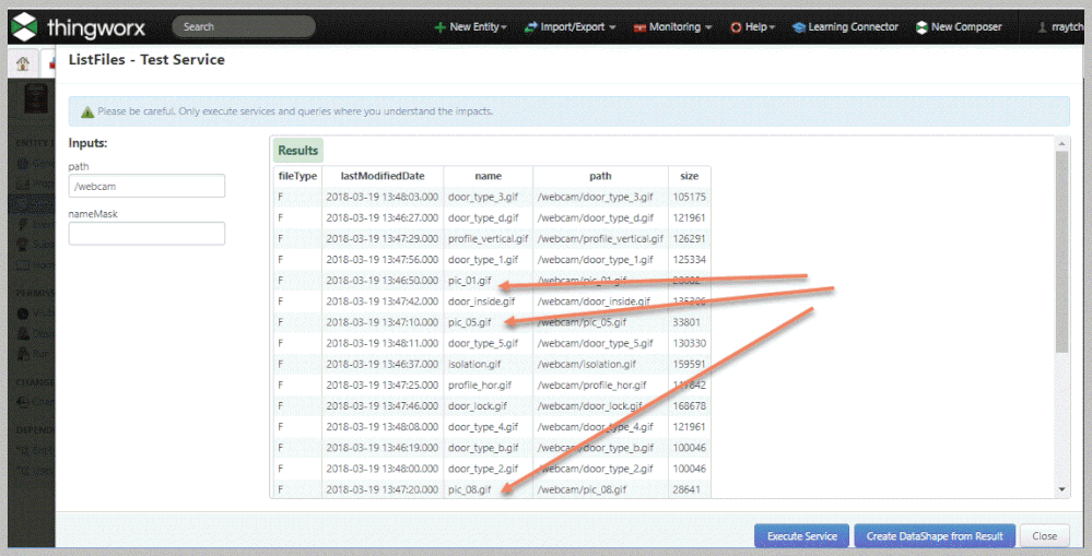

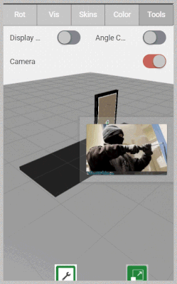

Hi @mziemniewicz ,
I am not sure what your code does actually in detail and if all these steps are necessary to manage this task. Therefore, may be, here my answer will not be this what you are asking for.
Therefore could your pride the simples demo project where we can see what is the effect of you current code  when it works so the thing about some alternatives
About dynamic source of image I could remember a projected where I had some images in  an repository  and used some REST API call like this one:
//////////////// get File form Thingworx Repository RESP API
$scope.getFileFromRepository = function(name,image_id) {
var req = {
"method":'POST',
"url":'/Thingworx/Things/My_images-File/Services/LoadImage?Appkey="dfab15de-cfbd-4429-98df-7201d728457f" HTTP/1.1',
"Host": 'mrerot7o.studio-trial.thingworx.io:8443',
"Authorization": 'Basic Og==',
"Content-Type": 'application/json',
"Cache-Control": 'no-cache',
"Postman-Token": '5xxxxxxx-9xxx-5xxx-xxxx-d8xxxx1xxxx',
 "headers": {
 "authorization": "Basic Og==",
 "content-type": "application/json",
 "cache-control": "no-cache",
 "postman-token": "cxxxxxxx-xxxx-xxxx-xxxx-xxxxxxxxxxxxx6"
 "processData": false,
 "data": "{\"path\":\"/webcam/"+ name +"\"}"
$http(req).then(
function(response)
 {eval(response.data);
 var ret_str='data&colon;image/gif;base64,'+response.data.rows[0].Content;
 $scope.view.wdg[image_id]['imgsrc']=ret_str;
function(response){;}
Where I call it  from an interval callback
$interval( function(){
 if( global_count_int1 > 7) global_count_int1=0;
 global_count_int1++; //this count is contained by the image adress/link
 if(USE_REPOSITORY)
 	{ url_source="pic_0"+global_count_int1+".gif";
 $scope.getFileFromRepository(url_source,'image-2');
 else
 if( WEB_SERVER )
 var url_source="http://localhost:8080/webcam/pic_0"+global_count_int1+".gif";
 else
 var url_source= "app/resources/Uploaded/pic_0"+global_count_int1+".gif";
 $scope.$applyAsync(function() {
 $scope.app.params['image_url']=url_source;
 //this parameter could also be used for direct linking to any image sources
 ); //end applyAsync
 }//finish else USE_REPOSITORY
 , 3100);
And this will call the generared url from repository (if USE_REPOSITORY=true)
So this will change the displayed picture after 3.1 sec
This code above so far I remember was also working on the HoloLens.
When I looked second time on your code - I think you will write some dynamic html and then try to create a picture of it and to set to a image widget.
May be , it could be a good idea to generate the picture anywhere outside the HoloLens - for example on the Thingworx server and then read it from there....

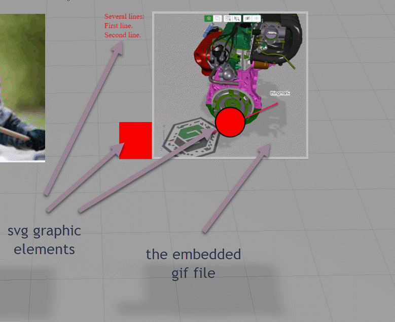

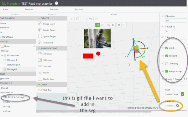

Hi @mziemniewicz ,
I did have now the same problem and it took for a while until I did manage it to work in preview mode and on HoloLens. May be, it  could be a helpful feedback.
So, following situation:
I wanted to generate a svg format dynamically and used it as source to add there a picture. So the picture should be displayed in the 3dImage widget and also I want to  write some graphics there – for example some markups.
Also adds some multiline text:
The widget 3DImage-2 has a value pointing to a particular  svg file but I will replace it by script. The script should generate the graphic and should read also a gif file (here app/resources/Uploaded/2019-01-28_18-34-34.gif) form the upload project folder. Then it will create SVG file format string adding also the gif file as string and will set it to the src property of the 3DImage widget.
The following script:
//load the image/picture file from folder as base64
const toDataURL = url => fetch(url)
 .then(response => response.blob())
 .then(blob => new Promise((resolve, reject) => {
 const reader = new FileReader()
 reader.onloadend = () => resolve(reader.result)
 reader.onerror = reject
 reader.readAsDataURL(blob)
//Creates a dynamic svg file add to it the "txtL" image base64 string
// and set it to the src property of the imgWidget
$scope.svg_ret = function(txtL,imgWidget) {
 var xmlsrc='<?xml version="1.0" encoding="UTF-8" standalone="no"?>\n'
 xmlsrc=xmlsrc+'<svg xmlns="http://www.w3.org/2000/svg" height="1000" width="600">\n'
 xmlsrc=xmlsrc+'<rect x="50" y="300" width="200" height="100" style="fill:red"/>\n'
 xmlsrc=xmlsrc+'<image width="700" height="400" href="'+txtL+'"/>'
 xmlsrc=xmlsrc+'<circle cx="350" cy="300" r="40" stroke="black" stroke-width="3" fill="red" margin-top="300px" />\n'
 xmlsrc=xmlsrc+'<text x="10" y="20" style="fill:red;">Several lines:\n'
 xmlsrc=xmlsrc+'<tspan x="10" y="45">First line.</tspan>\n'
 xmlsrc=xmlsrc+'<tspan x="10" y="70">Second line.</tspan>\n'
 xmlsrc=xmlsrc+'</text>\n'
 xmlsrc=xmlsrc+'</svg>'
//some warning to check the string
 console.warn('data&colon;image/svg+xml;base64,'+xmlsrc)
 $scope.view.wdg[imgWidget].src='data&colon;image/svg+xml;base64,'+btoa(xmlsrc);
// will start after View enter
$scope.$on('$ionicView.afterEnter', function() {
 //read 2019-01-28_18-34-34.gif
 toDataURL('app/resources/Uploaded/2019-01-28_18-34-34.gif')
 .then(dataUrl => {
 //set the src of 3DImage-2
 $scope.svg_ret(dataUrl,'3DImage-2')
So In preview it looks like:
2019-09-11_18-55-20.gifTested on HoloLens1 and it was also working ok.
