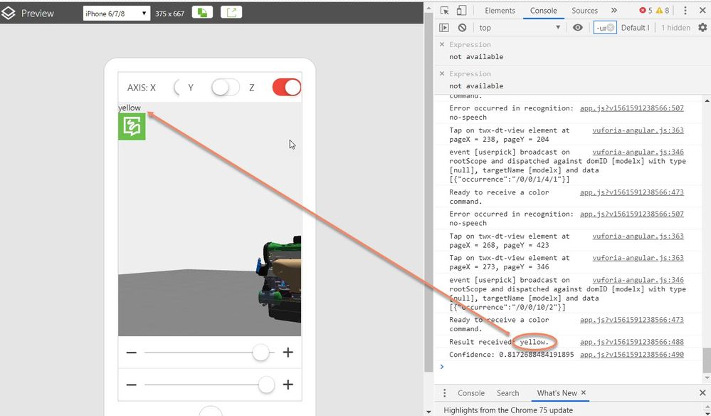

Here I tried to set a label text with voice... (the code is not the best I used is quick by copy and paste - but it was working in preview:
but as mention before -it was not working on android.
