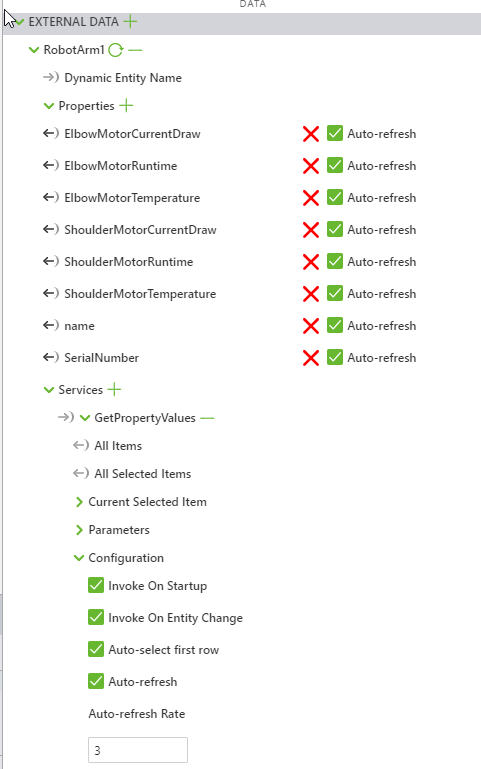

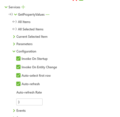

Hey,
What I am reporting used to work and within the space of roughly 1-3 weeks it no longer works.
I ran though the Fundamentals of AR Development course in PTC University and managed to complete the IoT Robot Arm Repair Project. The Project worked nicely where it was pulling IoT data from the RoboArm1 Thing on the ThingWorx Platform. For some reason now, the 3D gauge never updates with new values... Even though the service configuration is correct, see below
Any help please? Did the Vuforia Studio update affect this?

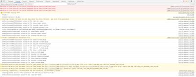

Hello Ryan Anderson,
In Vuforia Studio, in Preview when reproducing the issue, what is the output in Chrome, in Developper Tools, in Console tab ?
Best regards,
Samuel
Hey Samuel,
Here is the output:
BR
Ryan

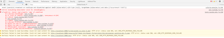

Hello Ryan,
I suppose that the data is not updated to the javascript exception thrown.
The solution is to solve it.
I have some questions :

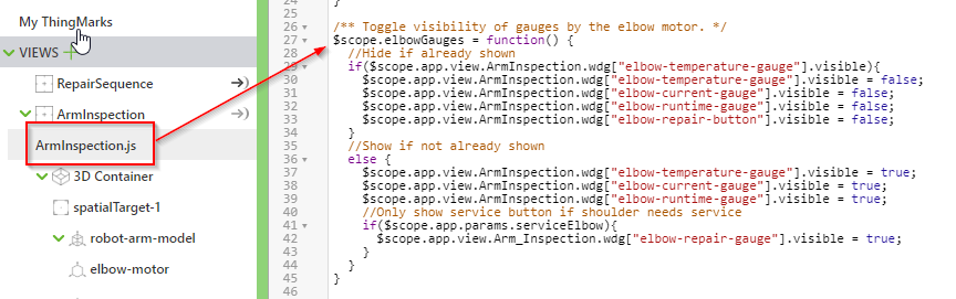

  • Do you have a custom javascript function named elbowGauges defined in <View name>.js node ?
  • In a 2D Widget with a Click Event, in this Event do you a call to a function elbowGauges(); ?
Thanks you in advance for your feedback.
Best regards,
Samuel
Hey Samuel,
Yes I do, I followed the "Fundamentals of AR Development with Vuforia Studio" Course on PTC University and followed exactly as presented (as mentioned it previously worked until I tested once again today).
See elbowGauges function below:
...And see that I call elbowGauges in a Model Item Click Event:
BR
Ryan

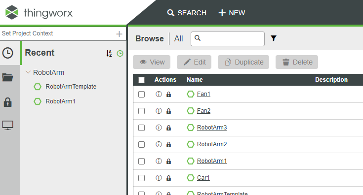

Hey Samuel,
I assume I still have access to the Things, Properties and Service. I am still able to login to my ThingWorx Composer instance @ https://twx.studio-trial.vuforia.io/Thingworx/Composer/
I also tried disabling Auto-Refresh on my properties and services and that did not work for me unfortunately.

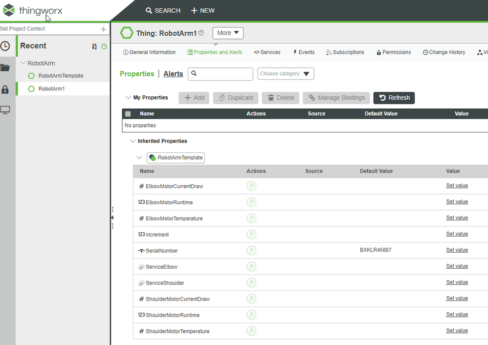

  • Is it possible to create a new and temporay user in ThingWorx with read permissions on Thing RobotArm1 and in Developer group, please ?
        Please send me in aprivate message this user and password. I would check if I am able to reproduce the issue locally here at PTC with in a more close environnent like you.
       If I am able to reproduce the problem, it will help to find the root cause and the solution.

Hey Sam,
I think I will need a little help with this. I'm not sure I can do any admin-tasks on this PTC Cloud-hosted ThingWorx solution.
Please PM me if required, else reply here.
TIA 🙂
