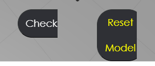

i am trying to change my font size to responsive, so that it will be able to view the complete text in any devices.
For example,
Thanks in advance 😀
