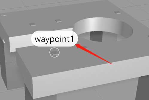

Hello dear PTC community,
In my vuforia studio project, I found that the waypoints labels text is too big.
I need to change the waypoints labels, such as color,size etc.
Please advise how can I do it.
Thank you.

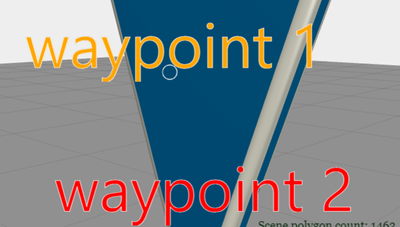

I don't know if there is a way to change wayfinder labels. I have always done this by creating my own 3D Labels in the same positions as corresponding waypoint, turn on the billboard option and change this Labels in CSS.
Dec 5, 2023 12:52 AM UTC
Thanks for the reply.
There is a more convenient way in the solution.
Hope you can enjoy it.

Dec 5, 2023 12:50 AM UTC
That's is what i need! I tried it and it worked.
Thank you so much!
