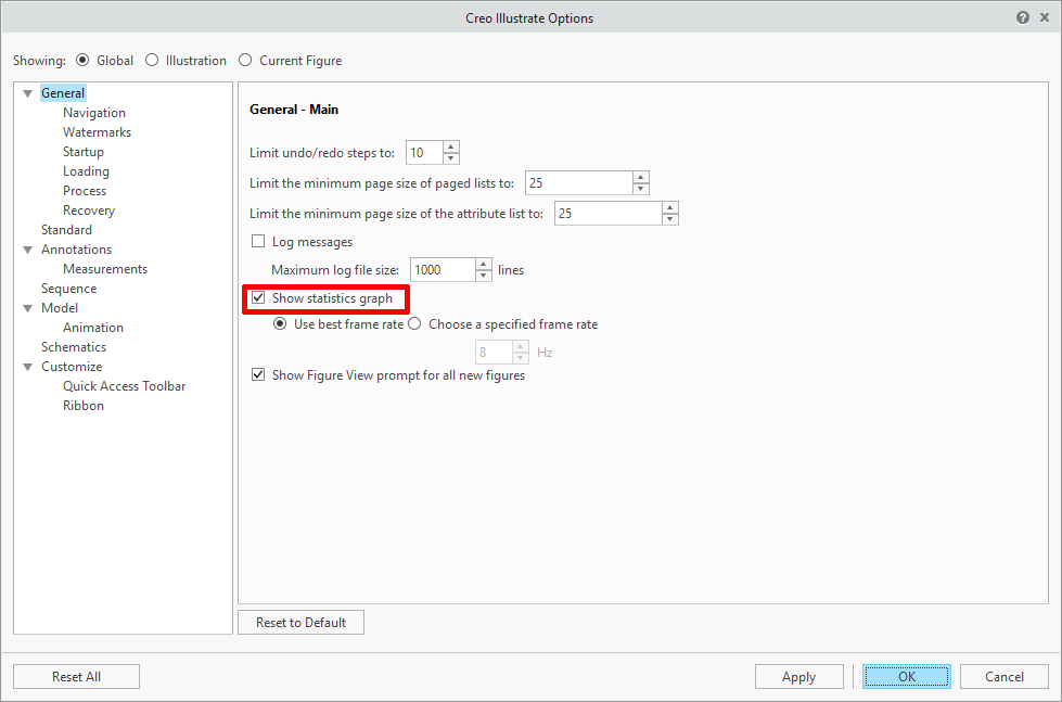

Hi Thadeus,
In Creo Illustrate or Creo View you go to File, Options and from the General - Main area, check the Show statistics graph option:

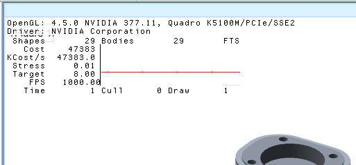

The in the top left corner of the graphics area you'll see some statistics:
The Cost value is the number of polygons on screen.
Cheers,
Allan
