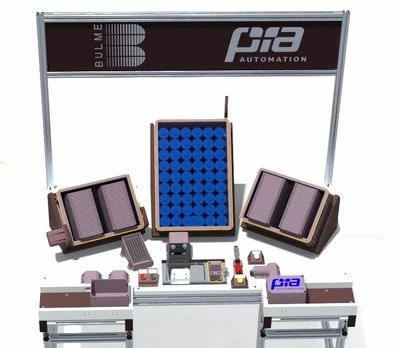

I would like to briefly describe what my students are dealing with and where we still have problems.
My students have designed and built an assembly workstation where various battery housings are to be assembled.
In order to train employees at this assembly workplace, an AR experience was created for the HoloLens.
The playback of the individual work steps (one after the other) is controlled via Thingworx parameters.
These parameters in Thingworx (Industrial Thing - Industrial Connection) are controlled via Kepware by a PLC Siemens C1215C.
Sensors check which battery housings are being delivered or need to be assembled and whether the work steps have been carried out correctly.
We also want to show waypoints for specific work steps.
The housings are delivered to the lefthand side of the worker - here we want to display a waypoint.
The worker then places the finished housing on the right side of the conveyor belt - we also want to display a waypoint there.
No waypoint should be displayed during the other work steps.

The Preview:
On HoloLens2:

armink6-ContributorAuthor
6-Contributor
Feb 20, 2024 6:07 PM UTC
First of all, thank you for the extensive answers, I really appreciate that!
The codes you sent me are helpful but are way too complex for my needs... .I attached You photos of my codes and the current situation of my Vuforia Studio project.
The label ("There are not enough lids...") you see above the language button would be replaced by a waypoint (with the corresponding text) which is placed on the left-hand euro crate later on... . My question now is how to solve it, so that the sequence is played when I get into the radius of the waypoint and how to show and hide them in a specific sequence.
