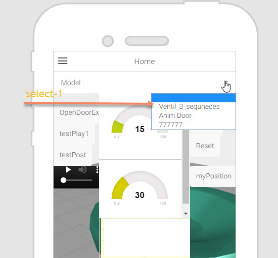

Hi Samuel,
I have an example where I am using a json list and it is working fine for the select widget
So I have in a project in the Home.js the following code :
//funciton which writes the the the json list into the select widget
$scope.populateModelList = function() {
$scope.view.wdg['select-1']['list'] = [
// here sellect-1 is a select widget / list element
    display: "Ventil_3_sequneces",
    value: "app/resources/Uploaded/Ventil_3_sequneces_publish.pvz"
    display: "Anim Door",
    value: "app/resources/Uploaded/anim_door2.pvz"
    display: "777777",
    value: "app/resources/Uploaded/777777_TT_GG_FFF.pvz"
Where I will call the populate function then e.g. in one of the following events
//after model is loaded
$rootScope.$on('modelLoaded', function() {$scope.populateModelList();});
// or
//after the view was entered
$scope.$on('$ionicView.afterEnter', function() {$scope.populateModelList();});
// here I could acces e.g. list items in the modelLoaded event because this event
//occurs earler
Now testing the list  in the preview  so it will work fine:
So I think the original problem is that you will try to add the list to an select element before is was loaded. So the solution is the use e.g. one of the event which I mentioned  above.

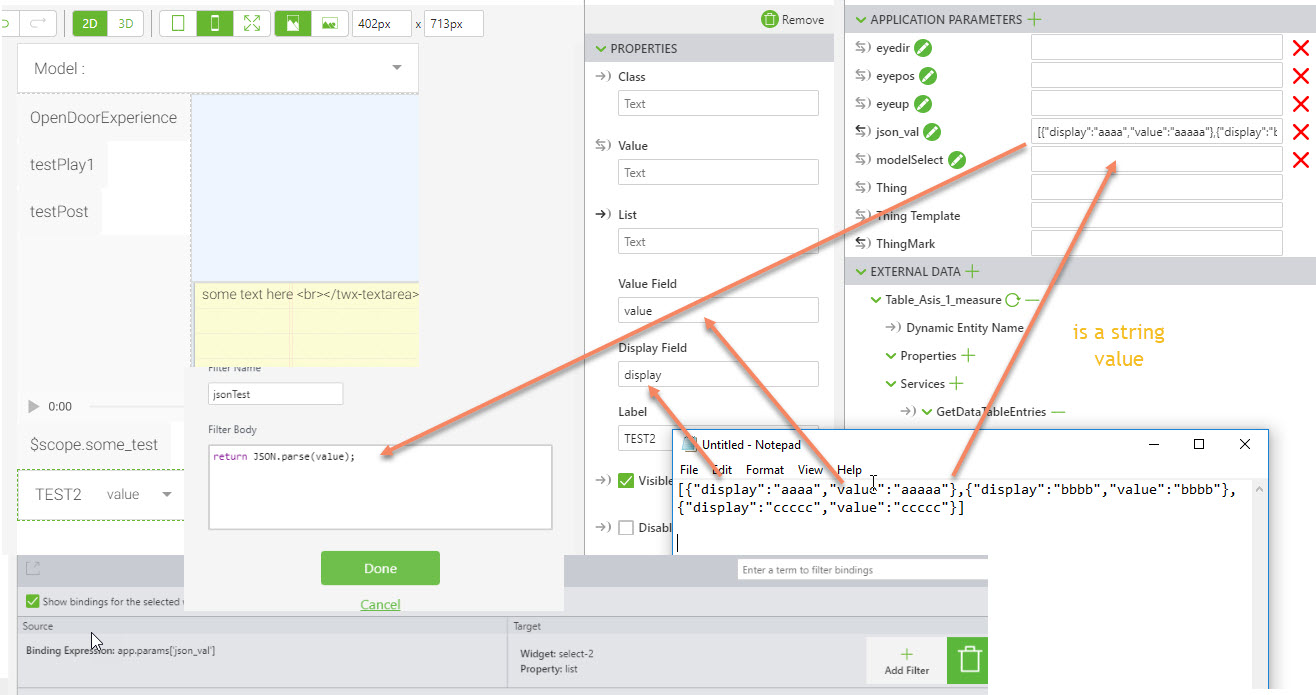

This will work, but you are missing one important piece: you need to add a filter to the binding, to convert the JSON string into a Javascript object. In your binding, add a filter, and in the filter include the following:
return JSON.parse(value)
For full details of how this works, see this post: https://community.ptc.com/t5/Studio/What-is-the-format-for-quot-List-quot-in-the-Select-widget/m-p/550949
Yes , this is  a  good point!
So when we set  the property list it stil a string and we need to be converted to JSON as mention above:
Otherwise when we fill the list attribute from java script we do not need to use a  filter because we can assignee there directly a JSON object.
[{"display":"aaaa","value":"aaaaa"},{"display":"bbbb","value":"bbbb"},{"display":"ccccc","value":"ccccc"}]

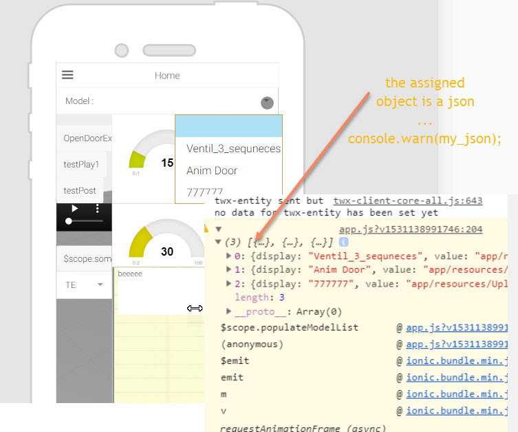

  var my_json=[
    display: "777777",
    value: "app/resources/Uploaded/11406550_CR4_VM_ILL.pvz"
  console.warn(my_json);
$scope.view.wdg['select-1']['list'] =my_json;
$scope.$on('$ionicView.afterEnter', function() $scope.populateModelList();});
