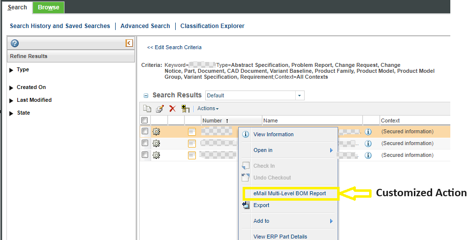

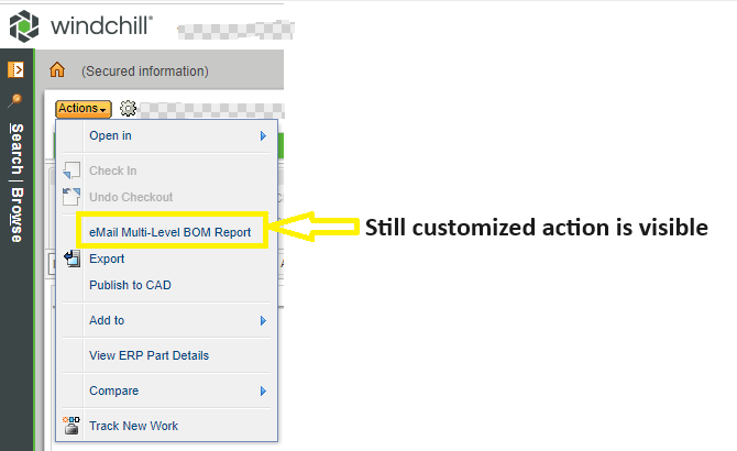

Hello PTC Community team/members,
I have created one customized action for WTPart but whenever I share any WT Part to Project Link that same action also visible into Project Link. Can anyone know how I can hide/remove that customized action for the team/role. Attached picture for the reference(yellow highlighted action, I want to hide).

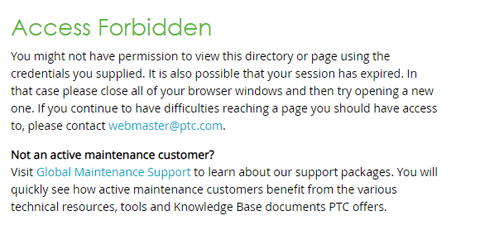

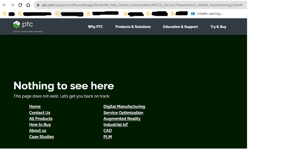

Hi PetrH,
Unable to access the link you shared. Getting below error.

February 5, 2024
Hi @Vaibhav_Thakare
It is a link to the Windchill help center 13.0.1.0
My access has been also denied to  13.0.1.0 so try  13.0.0.0
Implementing Validation Filters
or go to help https://www.ptc.com/en/support/help/Windchill and search for the Validation filter
