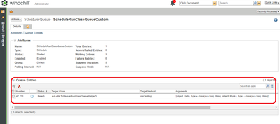

you can create your own scheduled queue (wt.queue.ScheduleQueue).
sheduleQueue = QueueHelper.manager.createScheduleQueue(name).
sheduleQueue.addEntry(....)

Basically, you need to create a scheduleQueue using the method
public static ScheduleQueue newScheduleQueue(String name)
And add schedule task in this queue, using this method:
public ScheduleQueueEntry addEntry(WTPrincipal princ,
 String t_method,
 String t_class,
 Class[] arg_types,
 Object[] args,
 Timestamp sched_time)
 The method and class arguments specify the public static method you have implemented, arg_types and args are the arguments for the method, and finally the sched_time for the task itself.
You'll likely have to schedule the next task in your custom method.
