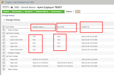

Hello
I want to use it to report date data on our activities.  Percent Change, Updated value, Last Value exc.

Hi @OO_10159664
try to crate report in querybuilder (report management)with activity and add all parameters what you need
PetrH
I know this, but I couldnt find the parameters I need. I tried all the parameters but still couldnt find it.
For example do you know which parameter I should use for updated value or last value ?
HelesicPetr
(To:OO_10159664)
Hi @OO_10159664
So you need to find where the history is stored.
There are two type of object that are shown in the table and should be connected to the PlanActivity
 com.ptc.projectmanagement.plan.ProjectManagementEventNmObject is just information about the history group
com.ptc.windchill.history.HistoryRecord stores the information you need
I would try to connect the HistoryRecord to the Plan Activity
Hope this can help you to crate report that you need
PetrH
Firstly, thank you, but I tried this, ı conencted acitivity and history record but ı couldnt find it. I think "Uptaded Value and Last value"  arent in this table. I think they should be in this table but they arent 🙂
HelesicPetr
(To:OO_10159664)
Hi @OO_10159664
The information can be on the Link.
So do not use direct link from activity to history record
add HistoryRecord Link table between Activity and History Record and link all together.
Try to select all attributes from the link. You may find what you need.
PetrH
I will try again and ı answer to you, thank you
