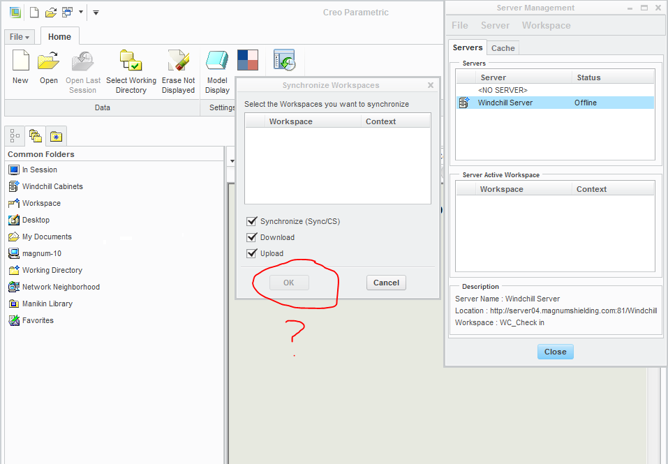

Someone else logged into their windchill account in Creo on my computer and then when I tried to log back in the server seemed to be down. I went to server managment and sure enough the server is Offline. I right clicked to uncheck "Work offline" button and the window the pops up doesnt let me click OK!

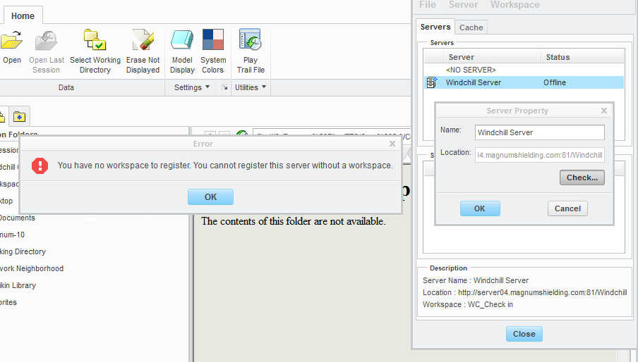

I right clicked the server and did a "check" but it gives me this error:
Does anyone know what this means: You have no workspace to register. You cannot register this server without a workspace.
Anyone think they know whats going on?
Best answer by MSC12
If anyone ever gets this problem again. I deleted the server I was using an re-added it. That seems to have resolved the issue
MSC121-VisitorAuthorAnswer
July 2, 2014
September 30, 2015
Can you please tell me how did you manage to delete the server?
The delete option seems to be disabled on my system
And this is the only server I have, Creo is not allowing me to add another server
2-Explorer
September 30, 2015
Right click on <NO SERVER> and make it primary server. That would allow you to delete Windchill Server
