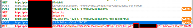

I justed wanted to return to this thread and close it out thought I still have a few more loose ends to wrap up. Thank you so much to @jbailey for all your help. We actually took this offline to keep thread smaller. Here is a summary of what I learned:
  • Metadata file must reference your proxy so that should be the domain you present to IDP.
  • bindingTemplate.html CAN be copied from PTC codebase so long as you are not doing anything fancy. Documentation has wrong location. Its in the codebase/templates folder not WEB-INF.
  • PTC HttpServer ServerName needed to match the proxy domain. This is what seemed to influence what shibboleth used in generating the Metadata file. I also received 404 errors getting the Metadata file when it did not match.
  • I still have issues with the sessionHook.jsp for which I have a PTC ticket on. Take note of this debug logger (sso.shibboleth.sessionHook). This was key to it complaining about the different domains. I was able to code around the issue but intend to return to OOTB hook. For now, its working as it should. I will try and collect my notes and write up something clearer.

Here is some testing of configurations info. My IDP has return URL as "https://pdmlink-test.mycompany.com..." pattern. With the configuration below:
<Sessions lifetime="28800" timeout="3600" relayState="ss:mem"
 checkAddress="false" handlerSSL="false" cookieProps="https"
 redirectLimit="exact" >
yields a urlMismatchError from the IDP since it was being given "http://pdm12.mycompany.com..." as the URL. I can confirm that the metadata file indeed does show pdm12 as hostname and I can download it using https://pdmlink-test.mycompany.com/Shibboleth.sso/Metadata
In an attempt to fix this I modified the above configuration to the following:
 redirectLimit="exact" handlerURL="https://pdmlink-test.mycompany.com/Shibboleth.sso">
 Now my IDP redirects me to https://pdmlink-test.mycompany.com/Shibboleth.sso/SAML2/POST but I now get a 404 error. It seems that the IDP liked what it got but something went wrong between the proxy and the main webserver. I can see in the webserver access log the 404 message. Getting closer. Any clue where to look next? I think it might be the Shibboleth module configuration on the Windchill webserver.

Download the SAML Tracer extension for Chrome or Edge and redo the auth attempt from a clean session with SAML tracer open. It will help you figure out what isn't liked (if it is SP side or IdP side).

What was added was the Shibboleth and basic auth sections. The other proxy settings I've always had. I can see that its hitting the pdm12 webserver since its logs the URL and a 404 error. This is why I suspect Shibboleth module is throwing the error.
