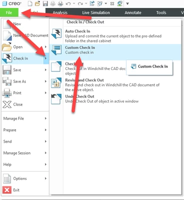

There are basically two ways to do a custom checkin, 1st is from creo with the part open. File, Check-in (arrow to the right) > custom check in.

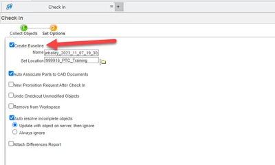

Second, if you rmb or checkmark in the workspace the object and do check in. On the set options wizard page, select create baseline.
A note of Creo (dis)functionality. If the ootb "Baseline" is turned off, aka instantiable "no" this will still create a baseline and ignore all of your OIR's if you have custom Baseline OIR's. PTC "Works to product specification"

In simple, you would do a custom check-in of the upper level assembly, check marking the create baseline.  Additionally, you can create a new baseline in Windchill, and use the configuration rules in the collector to grab the appropriate components.
