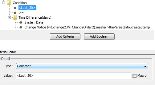

That's a good point - I think you could only use if/else/case logic outside of query builder, but inside of it maybe you can use the "Time Difference(days)" comparing the Work Item.Last Modified attribute to sysdate, and you can at least get the results from the past 30 days?  Granted if you ran it in the middle of the month you'd get from mid-month to the previous mid-month ...

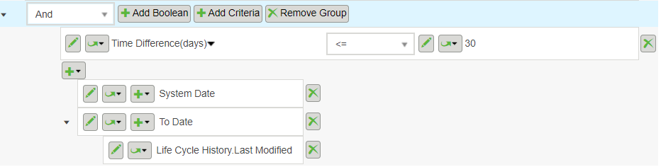

April 30, 2021
In Windchill 11.1 I was able to set a criteria with days while using the Database Function Time difference;
