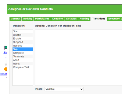

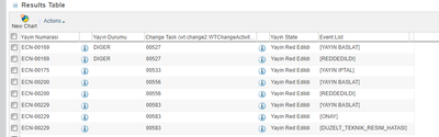

I need a query builder report but I don't know how to get it.
I want to get the list of Change Forms where "Skip" Transitions are used or "Cancel" mail robot is used in the activity.
Can you help me?

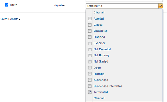

Hi @OnurNalbantgl
Your information is on second place.
If the task is ended by user with routing options, or just with completed and so on then information is stored in the WfVotingEventAudit table.
If you are looking for the system completion, as a termination, skip atc, then information is stored in WfAssignedActivity table in column state
Select state ,* from wcuser.WfAssignedActivity

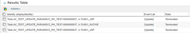

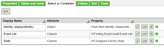

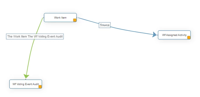

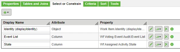

Hello Petr,
I hope you had a nice holiday. The picture you sent me is exactly what I want but I can't get there.
I think I'm selecting the wrong reportable Item.
My Table And Joins, constrain and report are as follows;
What do you think I'm doing wrong?

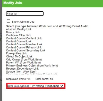

Hi @OnurNalbantgl
The point is that you need to use outer join or something like that because , the information in the WFVotingEventAudit does not exists for terminated tasks
So you need to get results where rows does not exists in the WFVotingEventAudit table.
PetrH
It happened this time. Thank you very much, Peter. thanks for your effort. 🙂
