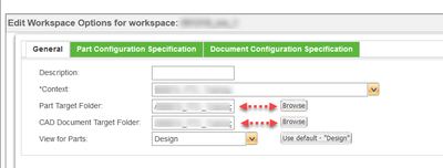

You can assign a default commonspace location to each workspace.

One possible solution - you could use workspace preferences to set the location for CAD/wtparts on upload. That way any file that is "new" from that workspace will go to that location.
From the workspace table, click the edit pencil, then set the folder location

I just did a Save-As on a file in my workspace and you can specify the location for the new file.
