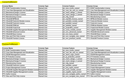

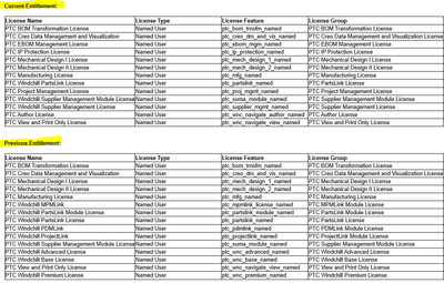

Mar 3, 2025 2:52 PM UTC
@BrianToussaint
with the “manual” setting you should see something like this
Default is Retrieve license online
Marco
