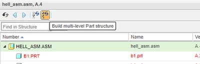

Best answer by HelesicPetr
hi @Amirtharaj_K
The build action is in the right click on a CAD in a workspace
For some additional information compare the CAD Structure to WTPart, it can help you to identify the reason.
btw from the Compare to Part Structure you can build multilevel structure
PetrH

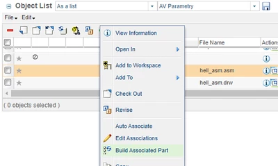

Hi @Amirtharaj_K
If you just check-in WTPart duting association. then there is no propagation info from CAD to WTpart,
You need to use Build Associated Part function from workspace to correct the propagation.
Function is available in a right click menu on the CAD Part from workspace or from detail page action menu
CAD Part can not be check-outed
PetrH

HelesicPetr
September 18, 2023
Hello @Amirtharaj_K
You need to click on the CAD Document the 3D model.
If 3D Model is check-in and WTPart does not exist then the WTPart is automatically created and the build is done during an auto-association and the behavior depends on a preference configuration.
if 3D model has been already checked in and WTPart does not exists, then the "manual" auto-association creates a wtpart with a link to 3Dmodel , but it does not build the attributes, visualization and structure.
In this case you need to use the build association part
