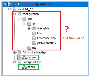

@Arpit-Singh,
CS337554 states the following:
When groups, administrators, etc. are migrated to the database, they are removed from the LDAP.
When the Info*Engine configuration is migrated to JSON files, the node still remains in the LDAP.
Is it safe to manually delete the 'configuration' node from the LDAP after updating to 12.0.1.0?  Is there some reason the migrator does not automatically remove this node?
Mar 7, 2021 12:47 PM UTC
The cn=configuration is not removed during update/update, though it will not be used, customer may choose to delete manually.

Mar 8, 2021 2:03 PM UTC
@Cliff_17466,
Thank you for the reply.  This then leads to three other questions:
  1. If the data has been migrated to the JSON files, why doesn't the migrator also remove this old data from the LDAP just like it does with groups?
  2. Is there any good reason why this data should be kept and not deleted?
  3. Can you please update CS337554 and possibly CS335696 with this information?  I've been asking about it for over a month and you are the first person at PTC to definitively state that it can be deleted.
