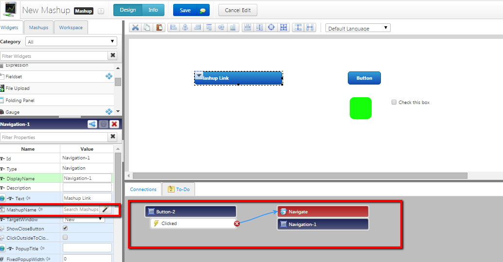

You can use the Navigation widget to implement page jump.
January 7, 2016
You can use the Navigation Widget to be directed to a new Mashup. You need to give the name of the Mashup you want  to be directed to in the MashupName property of the Widget.
You also need an action event that will trigger the Navigate event. This could be the click event of a button or a shape Widget or the Change event of a CheckBox Widget, etc.
Please let me know if this answers your question.
