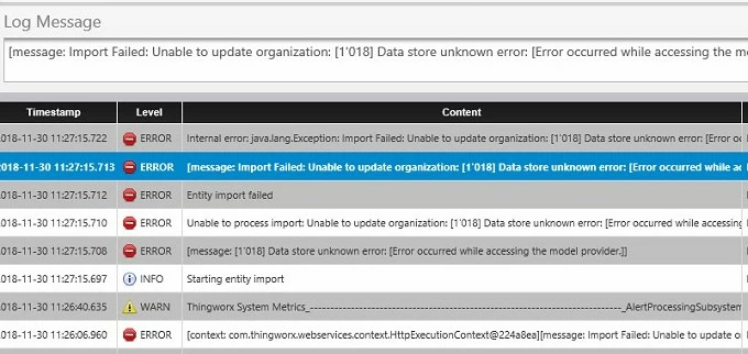

We have a TWX 8.2.5 on a Windows Server with MSSQL DB in an offline Production Environment.
We tried to update some parts of the running TWX Application (Mashups and some backend functionality in Things etc.)
But we can not update entities in Composer or import new Extensions because of this generic error: [[1'018] Data store unknown error: [......"
What are possible causes of this error?
- Space on devices is good >20GB on the two harddrives.
- Memory is ok with room for more
- Tomcat and MSSQL restarted serveral times
- Tomcat configurations without Memory Settings
What can we try to fix this error? We didn't have access to the instance all the time. So I want to check all possibilities before connecting again.
Attached a small screenshot from logview
Soo update on this.
We found the issue ...
Short Version: Database was "Full"
Long Version: We used MSSQL Express (has a 10GB Quota on DB Size) but the DB Size was around +4GB so we did not think in the DB full way any more. After Setting up a new Server with the local administration to mirror the system, we found out the admins set a folder quota to the DB Filesystem Folder. So MSSQL can't write to DB because of Storage full. Removed the Quota and all works as expected.

Christian,
Is this occurring in a single-sign on (SSO) environment?
-- Craig A.
