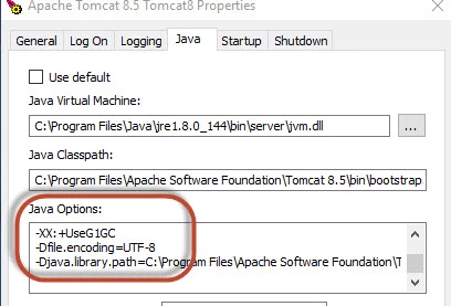

- Checking the parameter passed to the Tomcat's properties from the Monitor Tomcat utility

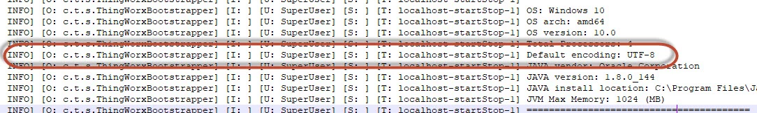

- When starting up ThingWorx, the default encoding is mentioned in the ApplicationLog (accessed from the \ThingWorxStorage\logs\)

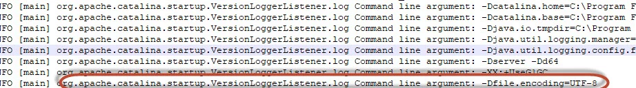

- Checking it directly from the Apache Tomcat's catalina log (access from <TomcatInstallationDir>\Apache Software Foundation\Tomcat 8.5\logs)
