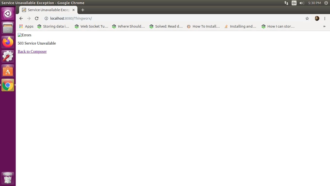

Hello Friends ,
After making subscription on datachange event of property value,suddenly this error will be come and thingworx is stop working .
Error
503 Service Unavailable
Back to Composer
I have installed ThingworxH2trial8.4 version with mqtt extension

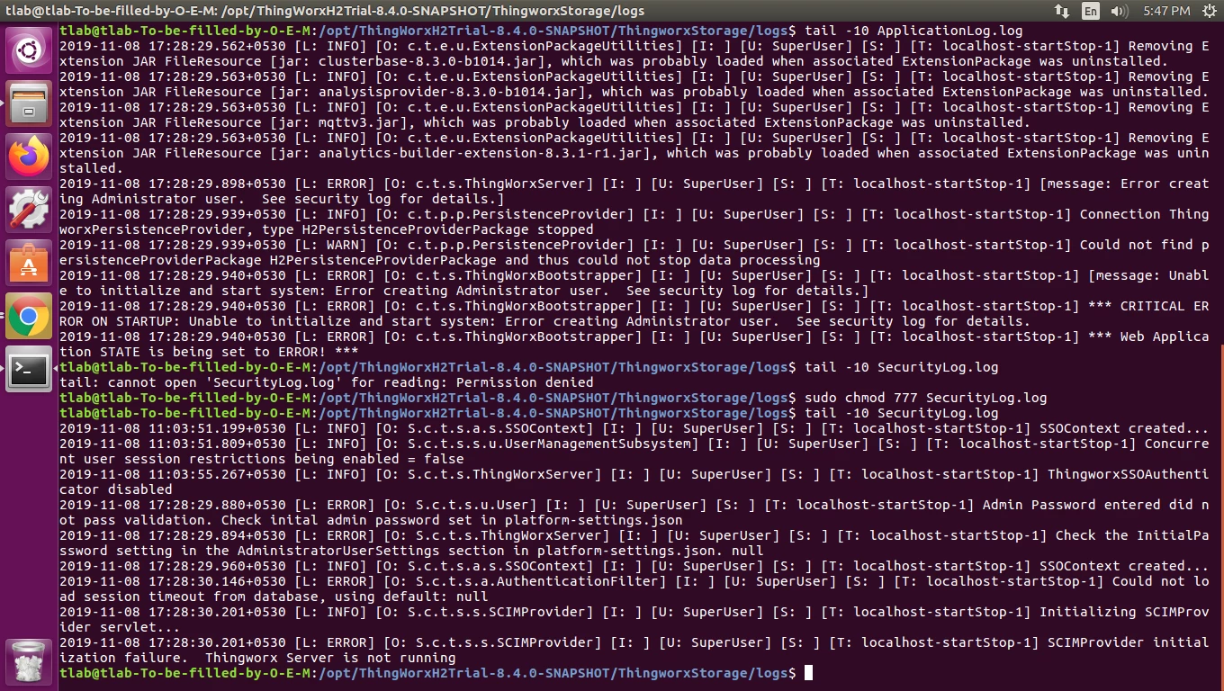

Posibilities:
1)I got realtime data in valuestream and I want to parse those data so I have made subscription of datachange event on property,It happen because of recursion ???May be this is first reason .
2) I have set   (You have to go to your ValueStream and click on ThingworxPersistenceProvider and click on View. Than you must start the AddVisibilityPermission-Service of the PersistenceProvider:) to got real time data in value stream  ,It may be reason ??
See Application and security log  in snapshot

Hi @it15.
After reviewing the screenshot of the log you provided, there appears to be a problem connecting to your H2 database.  I'm guessing that after rebooting the server, you are running something that is using the same port as H2.  This could explain why it works after a restart.
Here is a link to an H2 tutorial that may help you track down the cause of the problem.
Regards.
