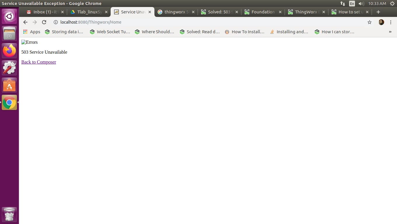

503 Service Unavailable ThingworxH2Trial
Hello Friends ,
I have ThingworxH2trial 8.4 version installed,Everything is running right way but when I shutdown system and have been started at morning ,This error shows ,
Following are applicationlog and security log files to refer.

2019-11-13 10:23:30.888+0530 [L: ERROR] [O: c.t.s.ThingWorxServer] [I: ] [U: SuperUser] [S: ] [T: localhost-startStop-1] [message: Error creating Administrator user. See security log for details.]

2019-11-13 10:23:30.876+0530 [L: ERROR] [O: S.c.t.s.u.User] [I: ] [U: SuperUser] [S: ] [T: localhost-startStop-1] Admin Password entered did not pass validation. Check inital admin password set in platform-settings.json
2019-11-13 10:23:30.885+0530 [L: ERROR] [O: S.c.t.s.ThingWorxServer] [I: ] [U: SuperUser] [S: ] [T: localhost-startStop-1] Check the InitialPassword setting in the AdministratorUserSettings section in platform-settings.json. null

It's pretty clear that you're having a fresh H2 installation, and platform-setting file needs you to configure a user and password for H2 database.
