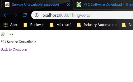

Please, asking for help and guidance,
I am installing TWX 8.4 with H2 on a Windows 7 computer and I have no license yet,
I have installed Java, Tomcat, but after following the installation manual for TWX, when I try to open the webpage, I get the 503 error attached,
Please, any tips here?
Tks,
Chris

April 28, 2019
Seems there is an issue with a password,
See attached logs
vieirac110-MarbleAuthor
April 28, 2019
Here is the error:
2019-04-28 18:42:46.301-0300 [L: ERROR] [O: c.t.s.ThingWorxBootstrapper] [I: ] [U: SuperUser] [S: ] [T: main] [message: Improper value found for model provider configuration password, system cannot start without valid password]
