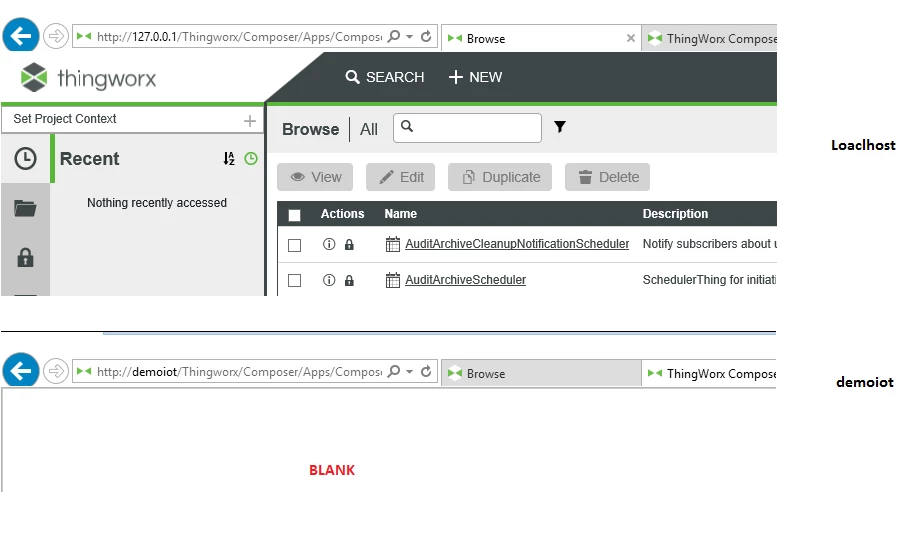

Hi to all.
When I connect to TWX by typing "localhost" in the web address field - everything works fine. But if typed "<local hostname>" I see a blank page. ThingWorx asks me credentials in both ways.
<local hostname> = demoiot
 Windows 10
Java 1.8.0_92(64)
Tomcat 8.5.23 [tomadmin/
PostgreSQL 9.4.21
ThingWorx Platform 8.3

What is a problem?
Many thanx
P.S. I was typing "localhost" in all fields where it was needed while I was installed TWX and 3rd-party software.
pgAdmin III works fine with "demoiot:5432" server name.

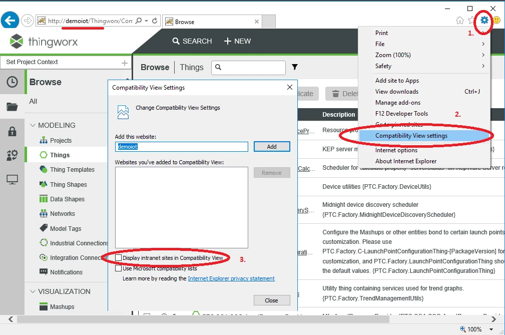

Hi to all.
I'm sorry that I kept silent. I was trying to solve the issue in many ways (including all the advice on the top). In the end, it was easy to solve - I just turned off "Display intranet sites in Compatibility View" option in IE (see a picture).

Hi @EvgenyUraskin.
These things come to mind:
- Entry in hosts file
- Modified Server.xml file
- Firewall rule
