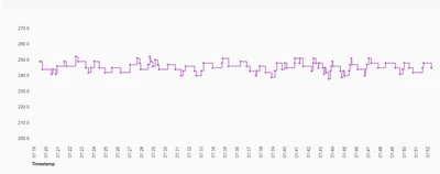

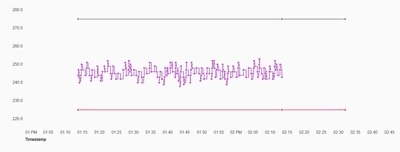

I am trying to zoom into a line chart that has limit lines made:
I want to be able to see these limit lines still if I zoom into the image, but they disappear even if I keep them in the zoom range:
Any tips on how to get this line to stay even after zooming?

Aug 2, 2024 12:55 PM UTC
That post doesn't necessarily help answer this question. It is more so just being able to keep the lines visible even when I zoom in on the graph when my zoom doesn't include the limit line data points technically (still would like to show the lines)

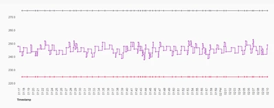

Aug 2, 2024 12:51 PM UTC
Am on 9.3.13. It works to zoom if the data points are within the zoom range, just not if they are outside the zoom range, since the data isn't seen so the limit line can't be drawn. I found a work around where I can just plot a bunch of data points for the limits over various timestamps, but then I see a bunch of points which doesn't look great:
Aug 2, 2024 1:48 PM UTC
Do you know if there is a way to eliminate the data points dots? Or shrink them? I don't really want them there for the limit lines.
