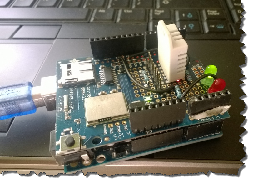

Able to post from browser by not via Adafruit_CC3000
I have a question around connecting to my local Thingworx server

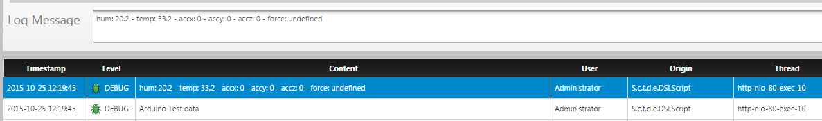

If I run the following below from the browser (98.XXX.XXX.XXX redacted). Which is a copy of the output from the Serial port com 7 when running the Arduino
98.XXX.XXX.XXX/Thingworx/Things/Arduino_RND_Thing/Services/Arduino_RND_Service?appKey=978d51a7-a095-482f-94d0-7ba142c9d581&method=post&x-thingworx-session=true<&humidity=20.20&temp_c=33.20&temp_f=91.76&accel_x=0.00&accel_y=0.00&accel_z=0.00>
It executes the service and updates the values shown below

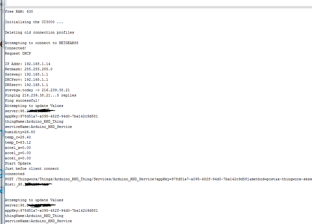

If I run the same thing but use a cc3000 shield I do not see the results in the monitor
Below show the output
Attempting to update Values
server:98.XXX.XXX.XXX
appKey:978d51a7-a095-482f-94d0-7ba142c9d581
thingName:Arduino_RND_Thing
serviceName:Arduino_RND_Service
humidity=20.20
temp_c=33.20
temp_f=91.76
accel_x=0.00
accel_y=0.00
accel_z=0.00
Start Update
Just befoe client connect
connected
POST /Thingworx/Things/Arduino_RND_Thing/Services/Arduino_RND_Service?appKey=978d51a7-a095-482f-94d0-7ba142c9d581&method=post&x-thingworx-session=true<&humidity=20.20&temp_c=33.20&temp_f=91.76&accel_x=0.00&accel_y=0.00&accel_z=0.00>HTTP/1.1
Host: 98.XXX.XXX.XXX
The tomcat server never sees the post but the shield says it connected and its able to ping a server for stevegw.today but it does not get pings from server:98.XXX.XXX.XXX
