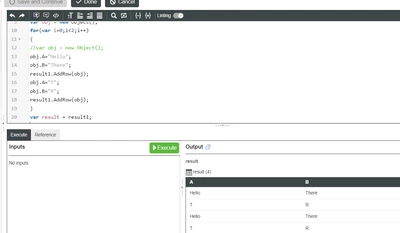

Hello ,
I am trying to pull data from json based on various inputs. i have placed some conditions and write 3 if statements and in that if statements i have created var newEntry- new Object() and also write result.addRow(newEntry) in all 3 if statements. in logger its working fine but unable to display infotable and its still executing and goes into infinite loop.
so I want to know when and where need to create newEntry object and where i need to write result.addRow(newEntry). please help me out on this.

Can you try creating the object out of these blocks, even if you have these blocks in a loop, then try to put the new object out of the loop. Ideally, if you create the object only once and add the rows to the object as per the condition it should work. It works something like this:
var obj = new Object();
for(var i=0;i<2;i++)
obj.A="Hello";
obj.B="There";
result1.AddRow(obj);
obj.A="T";
obj.B="R";
Where A and B are my fields of DataShape.

Hi Mukul,
Thanks for your reply.
what ever you have suggested in the above code, there is a chance of overwriting the data which is already in result object. I means when
obj.A="Hello";
obj.B="There";
obj.A="T";
obj.B="R";
The Highlighted result1 will be replace the data with new one.

Nothing will be replaced, you have already added the previous row and then you are adding a new row. Here is the output of this code : If you see the output it is adding 4 rows(which is expected).
