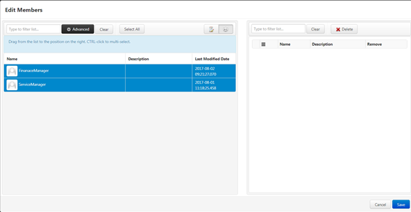

  • Click the Edit Members button.

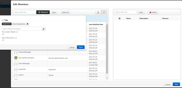

  • Click the Advanced button.
  • In the Search ModelTags field select the tag that you have used during the creation of users and user group.
  • Click the Done button.

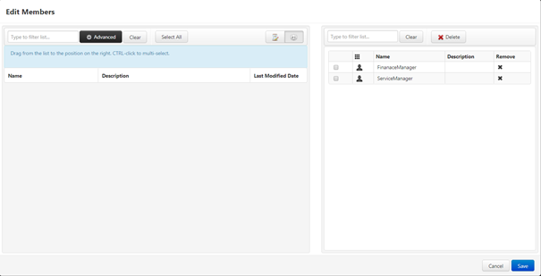

  • Click the Select All button.
  • Drag the three users to the right panel.
  • Click the Save button.

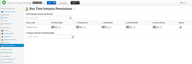

Now assign the permissions to the group as a whole.
  • Select your desired Thing.{for children select the desired rooms}
  • Click the Run Time instance link in the explorer.

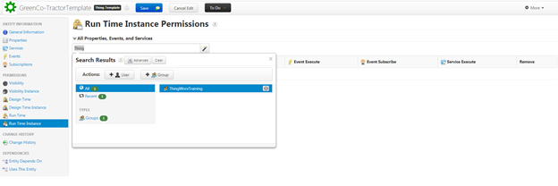

  • Type the group name in All Properties, Events, and services filed.
  • Select the green dot for Read, write, Execute…
The users in the ThingWorxTraining group will have all the assigned permissions and they can view/edit properties of only this thing. Please let us know if this is the scenario you are trying to implement.
