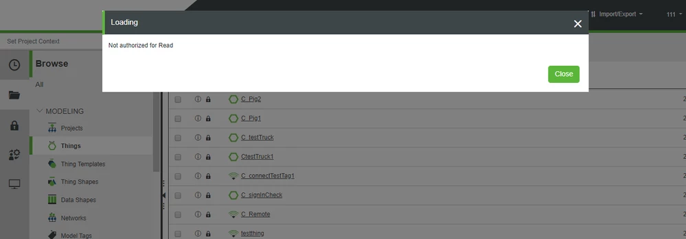

Hi everyone,
I am using ThingWorx 8.4.0 and have some problem.
When I set visibility permission for a thing, if it will become what I think, some users can see it in menu and others can't see it anywhere?
or it just like in the picture, all users can see it in menu but someone can't click in it?
I have deleted all users in organization "EveryOne".But all users, admin and others, still can see all things, temples, shape and others in menu but just someone can't click in them.
I even created a new thing and then give it an empty organization for its visibility, but it still could be seen by all.
I don't know what I ignore.
Thanks.
Best answer by CarlesColl
Visibility permission should kill any options for an user that doesn't have the permission for the visibility to see/discover it. If the user it's able to see it, then you should have something wrong.
July 16, 2019
DragC1-VisitorAuthor
July 25, 2019
Thanks.
There is something wrong actually. I don't know where I clicked and it was correct as if it repaired itself.
