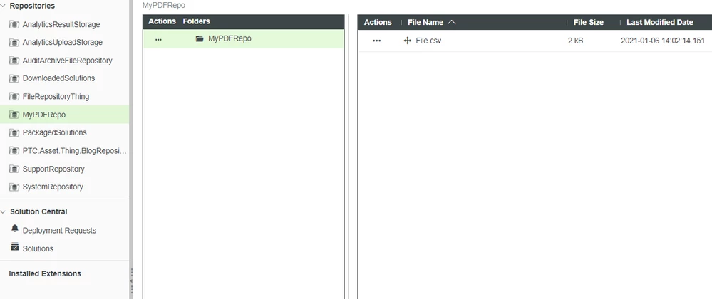

Hi ,
I am looking to access csv file from SystemRepository , i have stored the file in SystemRepository of Cloud Instance of TWX..when i use getFileListing() it asks parameters like below but not getting how to set path of repo and namemask..also check repo snap..

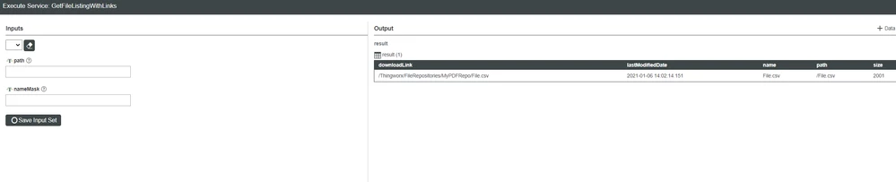

You would upload the csv file in the Repo Thing that you just created , I am pasting my example:
After that you can use the service GetFileListingWithLinks to get info about the file path or list of files it contains :
Let me know if this helps you,

Jan 6, 2021 5:55 AM UTC
@Ashritha ,
My file is at SystemRepository on Cloud instance of TWX so i can access directly without path ? or what should be path ? i had attached snaps whatever i had...and now i am getting empty result after executing getfilelisting like below ...
Jan 6, 2021 9:18 AM UTC
Hello @@VS_9760165,
You can execute service GetFileListingWithLinks  to get the path.
Hope it helps,
