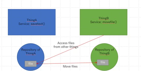

Hi All,
We'd like to access files in repository folder of ThingA from another things which are in the same project like ThingB.
Can we do that ?
suvermaAnswer
Feb 16, 2021 8:04 AM UTC
Hi @Yoshihiko.N
This is definitely possible to copy files from one Repository to another. Please refer to this  link for more details on how to achieve this use-case.
You can also make use of Copy Service of FileTransferSubsystem which gives an option to select source and target repository.
Do revert back for further query.

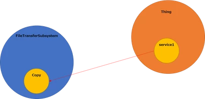

and I have one more question.
How can we call the copy service from services in other things ?
if you provide me code example, I'd be happy.
Feb 18, 2021 9:17 AM UTC
Hi @Yoshihiko.N
You can try something like below in your custom service where Thing A and Thing B can be your source and target repository:
Spoiler
var params = {
async: false /* BOOLEAN */,
sourceRepo: "RepoThing" /* STRING */,
targetRepo: "TargetRepo" /* STRING */,
targetFile: "Openssl command.txt" /* STRING */,
targetPath: "/" /* STRING */,
sourceFile: "Openssl command.txt" /* STRING */,
sourcePath: "/" /* STRING */,
timeout: undefined /* INTEGER */
// result: INFOTABLE dataShape: FileTransferJob
var result = Subsystems["FileTransferSubsystem"].Copy(params);
