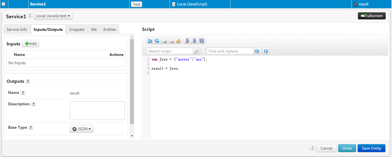

I have written MyThing.myService() that returns JSONObject.
return type=JSON
var ans=op1 * op2;
var Jres = {"answer":ans};
result = Jres;
external clients is only expecting JSON details (highlighted), but the HTTP response contains ThingworxLogo.png and few <TR> <TD> tags as below
how to get rid of these non-JSON data in HTTP response

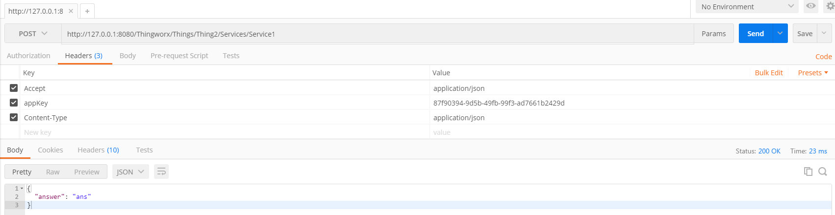

liliuAnswer
April 7, 2017
Hi Aniruddha,
liliu5-Regular MemberAnswer
April 7, 2017
Hi Aniruddha,
avaidya11-VisitorAuthor
April 7, 2017
Thanks for the reply
April 10, 2017
Hi Aniruddha,
Just let me know if the solution not work for you.
Lily
April 10, 2017
Hi Lily,
It worked for me, Thanks
