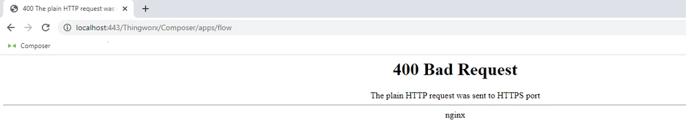

After installing ThingWorx Flow I go to Google Chrome and enter the address in the line according to the first section of this article:
http://support.ptc.com/help/thingworx_hc/thingworx_8_hc/en/#page/ThingWorx/Help/Integration_Orchestration/InstallingTwxFlowInstallationAccess.html
After that I get such an error.
How can I fix it?
yhanAnswer
March 21, 2022
Do you type the https in this flow url, like https://localhost:443/Thingworx/Composer/apps/flow ?
yhan17-PeridotAnswer
March 21, 2022
March 21, 2022
Yes, indeed ... Stupid mistake)) Then, however, "Access is denied" came out, but there you just had to confirm that you trust the site and are aware of the risk.
In general, thanks!
