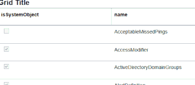

I am trying to set blinking of red color on thingworx grid based on a value for a particular column value.
I used State definition to achieve the same.
I created style definition using media entity and for media entity I used GIF for image.
But GIF moved to label the to an extent that it became invisible.

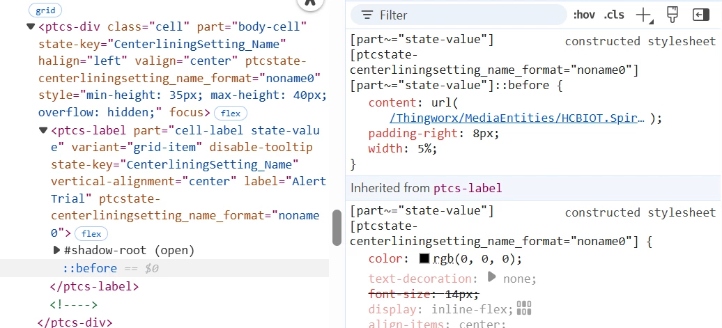

I have uploaded GridBlink image which shows red color but it is actually blinking and CSS from developer tools which shows the label inside column when width is reduced to 5%.
But when this css is used directly as custom css, It is not working. Have uploaded css also.
My requirement is to have blinking red color for a grid column and the label value should be appearing while blinking. Kindly suggest me how to achieve this

just to let you know that I tried to achieve what you want but also failed. I could not select the grid cells via css selector - as they are hidden in nested dom shadow-root elements which are not exposed.
😞Edit: I just found from another community post on how to apply custom css to nested shadow-roots: https://www.ptc.com/en/support/article/CS377455?as=1  Maybe this could help. I may try again
😞🙂Edit2: it works - I attached sample mashup:
Check the "Custom CSS" tab. Also I used custom state formatting as selector for the cells (so only cells which have isSystemObject=true currently blink). customize as needed.
(Scrolling in grid causes different timings in css animation for each cell - you might want to look into this :P)
