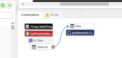

Hi ,
I am unable to add and delete row from grid advanced in Thingworx. i have a property in thing with base type infotable and i added few rows . i have Grid in Mashup which connects as below....
and grid properties as..below attached  i haven't created any service (tell me if its needed).
table i am seeing like in attached file

Hello @VS_9760165
As I could find out it is an defect that got fixed in 8.5.4 . You can refer following community post for the same
https://community.ptc.com/t5/ThingWorx-Developers/How-to-delete-a-row-in-advanced-grid-in-version-8-5/td-p/649782?art_lang=en&posno=2&q=delete%20row%20in%20grid&source=search

Hi @odukiya
I am using Thingworx 8.5.2.
odukiya16-PearlAnswer
Hello @VS_9760165
