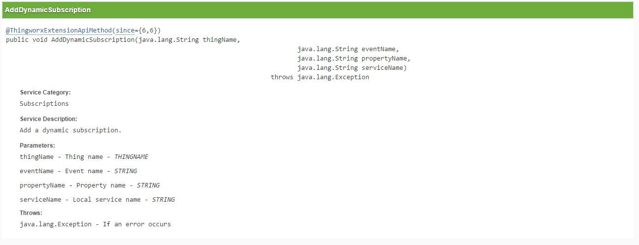

Can someone please explain this service to me? I am trying to be able to create subscriptions from a mashup and this seems to be the closest thing I have to work with but I want the ability to add them at a template level, which I would think is what this service meant by "dynamic" but it has a thingName parameter so what exactly does this do? And what is the serviceName parameter for? Is that a service that will execute when the subscription is triggered?
Thanks for the help!

The service you mentioned above will help you add a subscription dynamically for a Thing. I believe it is called "dynamic" because you do not add it in the Composer, you just use some code to add it at Runtime. With this service you cannot add subscriptions at thingTemplate level.
In regards to the parameter, thingName refers to the thing to which you are subscribing to (if you are subscribing to your own event, you don't need to modify it, just leave it undefined), eventName is the event you are subscribing to and it is mandatory, propertyName (in case the event is a DataChange, Alert on a specific property, you need to mention it) and the serviceName is the actual service (code) that would be executed once the event is fired. This is also mandatory.
One important thing to mention is that with this service you have the possibility to add on the fly 'in-memory' subscriptions, which means that after a server restart, the subscriptions will be deleted.
I hope this info was useful. Let me know if you have further questions.

Is there anyway to add subscriptions at template level during run time?

The indicated way to add a subscription is at ThingTemplate level, but why is it necessary to add them dynamically at runtime? Normally, these subscriptions are defined in the Composer and as new Things based on that template are created, they will inherit the subscription.
There is no straight solution for this, but I can show how you can add a subscription to a template dynamically, at runtime, by leveraging the ThingWorx REST API. Basically, it is the same request that it would be made if you had defined the subscription in the Composer, only you can use a snippet to "put" the JSON to the server, instead of the browser doing that for you.
Assume you have a thing template called SimpleThingTemplate and you want to subscribe to a Timer5s Timer event in order to execute some code (in my simple example, I just log something in the Script log). The service used in this case is PutJSON in order to make an HTTP(s) PUT request to the server. Nor all parameters are necessary, but the body of the request is very large. I have highlighted the important parts.
In order for the request to be successfully completed, you need a form of authentication. For testing purposes, I used a username and a password but normally you should use an application key. The result of the service execution is irrelevant so you can eliminate the var result at the last line.
Other than that, you need just to pass the URL and the JSON request content like below.
You can test this and let me know whether you have additional questions.
