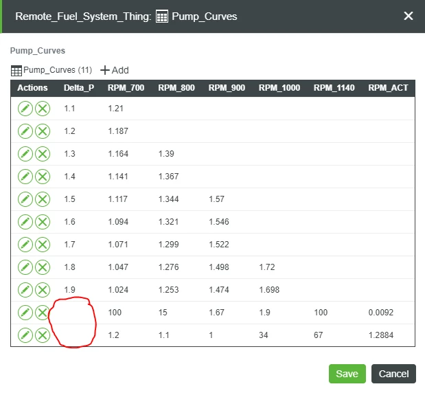

I am using the AddRow function to update an infotable.
It is copying values into all other fields except the primary key field.
Kindly advise me on how to correct this. See code snippet below and attached screenshot of the infotable.

This all looks correct, it shouldn't at all care about 'primary key' for an InfoTable.
The only thought I have is, try it with Delta_P set to 2.0 vs 1.87 and see what happens? or 2?
April 19, 2022
Thanks PaiChung.
I have tried 2 and 2.0 to see what happens.
The service still behaves the same way. The issue is not yet resolved.
